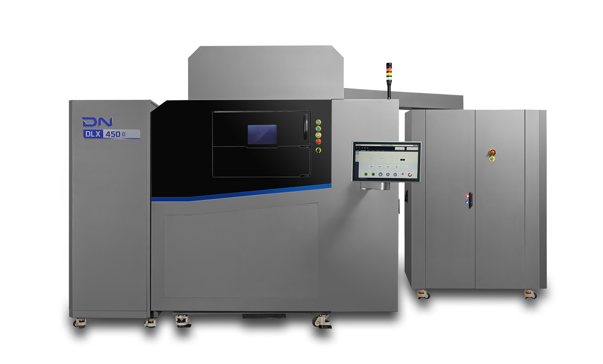

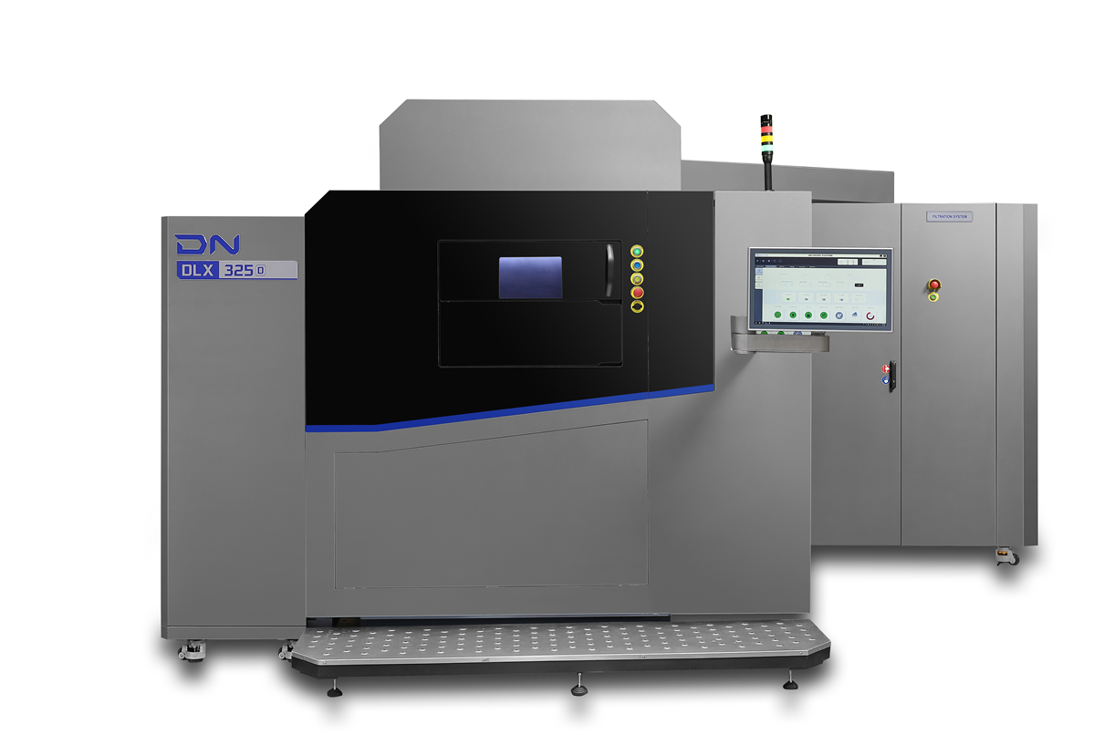

DLX 325D
4500 mm 2700 mm 3800 mm 4500 kg
325 mm 325 mm 420 mm
Yb – Fiber Laser 500W/1000W
3-axis 80 µm
Permanent Chalk Argon/Nitrogen
DLX 450
4600 mm 2800 mm 4100 mm 5500 kg
450 mm 450 mm 450 mm
3-axis 80 µm
DLX 450D
450 mm 450 mm 470 mm
3-axis 80 µm
