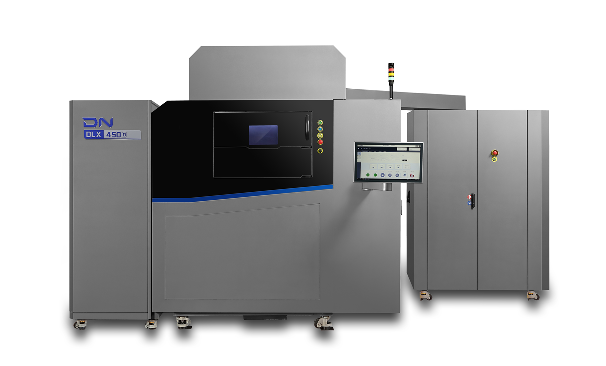

DN Solutions Laser eXecution solution
High-performance PBF system with best-in-class working area, exchangeable build containers, and full DNS integration for machining, automation & software — max productivity, seamless workflow.
End to End Offering End to End Offering
Software process chain Software process chain
Infinite Design Possibilities Infinite Design Possibilities
Various Materials Various Materials
￿ Highest Productivity
￿ with reliable part quality￿
Maximize productivity by using up to 4 lasers, ￿ advanced scanning strategies and bidirectional recoating.
Maintain reliable part quality by using uniform gas flow and precise 3-axis scanner motions.
All features are designed with minimizing the cost per part in mind to maximize your profitability.
￿ Automation of processes and minimize job to job time.
For increased operational efficiency, powder handling, powder sieving are optimized.
The job to job time is minimized by using exchangeable build containers.
Best in class volume
Offering uninterrupted 24/7 series production utilizing the segment‘s largest build volume and sophisticated powder management.
This allows for printing of a wide range of mid to large size fully functional components.
Easy to Print with a wide range of materials
DLX enables the production of highly precise and high-quality printed parts with a wide range of materials.
Standard materials are Aluminium, Titanium, Copper, Inconel, Maraging Steel, Stainless Steel and more.
